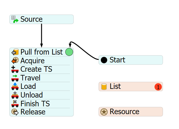

In attached model. I want to make operator 2 transfer flow item from queue 7 to queue 8.
But in process flow. The token doesn't move from Pull from list activity to next activity
Please help me
Thank you!

Hi @Jonathan_Huang
Ensure pushing the list before pulling it.
The list is empty (i.e., there are no values to pull from the list). So it is showing in red
Jonathan_Huang
Thank you Mr Sri_vkas
It worked as my expectation
