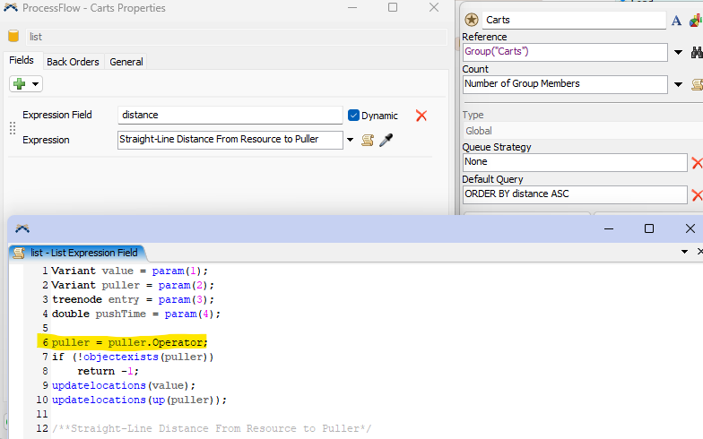

I have a group of task executer and a group of operators, when I acquire both for a task, I need to acquire the task executer which is closest to the operator. How do i do that on process flow? I believe I need to write a query to filter it on the acquire block, but i don't know how.

You choose first your operator. When you acquire a taskexecuter, you pass in a puller. This must be in a way be able to reference a location of your operator in a dynamic field of your resources to compute a distance to list values. Then you can order by this distance field the list values and acquire a resource.

edited: correct me if I am wrong but I think I did a mistake creating a global list and adding the pull/push for list blocks, i just needed to edit the advanced part of the resource, passing puller(token.Operator) and the expression field to pick the close distance.

You are correct, you do not need a separate list. A resource that is linked to actual objects already creates a list for those internally and functions the same, just with fewer settings in the Acquire activity then in Pull from List.
One of those missing options is the ability to set who the "puller" is, so you need to shift the reference in the list field code. (The base for the list expression is the "distance" option from the "Fixed Resource" category)
