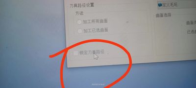

What is the reason why the Partmaker surface function cannot be used?
2649063614
无法正常选择在曲面页面上的锁定刀具路径,原因是什么??曲面也无法生成刀具路径?

Hello 2649063614
You must Generate the tool path before your can "Lock" it. So if there is no moves in the tool path then the lock is not available.
