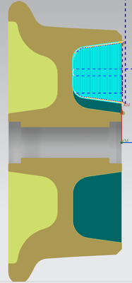

Yes I've used cut grip. its kind of got the idea but it doesn't give you the option for arcing in and out.
the whole concept of wave form turning is that is keeps a constant depth of cut, basically the turning same as the vortex milling.
the arcing in and out keeping a constant depth of cut is what makes wave form turning.
I've attached an example from edge cam.
