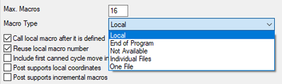

I have a part with a lot of holes/similar features that I am trying to post using a sub program. When I go into the post process, I deselect 'disable macro' and post my program. The issue I am seeing is the tool goes to the first hole location, calls a sub program, but doesn't post the rest of the hole locations anywhere I can find. I am probably over looking something, as I am not overly familiar with the software. I attached a couple screen shots, N72 is the sub routine call, but I cannot locate program M0001

Hello @ryan
As you have not shared the post, or the controller brand and model, it,will be guessing.
By default xBuild allow several configurations for the macros :
They can be defined locally (inside the program) at the end of the program, in one or several separates’ files.
But your post may also be incompletely set for handling sub programs.
The sub program start and call is clearly defined, but the macro linear, macro circular can be empty.
Cheers.
