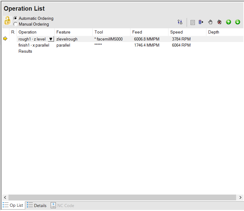

Just to check, this is the display I have for an example part
Are the feed and speed columns not in the Operations list? Or are the values not appearing in the columns themselves?

ramosf
it wont give me any values.
when I create a feature it tells me the RPM 0.0 FEED 0.0
I can see the columns.
