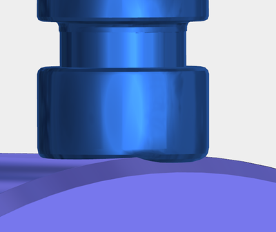

Anyone seen this before or know what might be the problem? FC knows this is gouging, it will pause if I have that option selected, but it does not render the gouge on the part like usual during 3D or machine simulation.
Pretty sure this used to work as expected, but am questioning myself now...
I can turn off all preceding features and completely bury the holder in the stock but it will only render the tool gouging, not the holder.
FC2021, holders are defined using imported step files from the manufacturer. All dimensions look right in the holder definition.
Doesn't seem to be limited to any specific part, feature, post, tool, holder etc.
The part I was working on when I noticed it:
Test part, showing buried holder:
Same part, completed simulation:

Also does not appear to be connected to any one tool holder model - ALL my holders defined by solid models behave like this. Parametric defined holders render gouges normally. I haven't checked with curve defined holders.

After a bit of messing around with the sample session ...I managed to repeat this behaviour once and only the once ....really strange.
After that though .... all sorts of strange behaviour .... both tool and holder disappeared completely ...Yet the gouge still appeared during simulation. Rapidcut was selected even though 3D sim was showing as selected  ...Stuff like that!
I've now reset my ezfm_ui.ini and all is good again.
