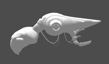

Let me put the cherry on top for you and for @ilan.keshet also. Here's Blender importing a Maya mesh (not using FBX SDK) and the normals are wrong in the exact same way as in my engine:
In the above example, you can see that Blender then deforms the mesh into the pose, meaning the normals are now double-transformed (creating the very dark wing). Blender's devs didn't catch the issue; @ilan.keshet and I did.
Blender offers the option to not accept the normals, in which case Blender re-computes the normals:
...and hard edges are lost... ooooof!
So they are trusting the export purely as FBX describes it. They may be unaware of the Maya export issue, but it would require something like what we're discussing to work around it, at least partly.
But no workaround appears to solve the matter. All of this can be avoided if the normals were not baked, and it would be nice to see future versions of Maya not have this problem. All our suffering would end!

The case where the FbxMesh GenerateNormals fails can be described in the image below, where the red line is a hard edge, and the rest are all soft edges.
In this case, there are 3 polygons above that should be smoothed together, -- and 3 polygons below that should be smoothed together. Unfortunately, -- in this case the FbxMesh GenerateNormals function fails, and instead shares 1 normal with all 6 of the triangles.

Results:
Using Fbx's GenerateNormals (and also I produced this before handling the case listed above)
Using my GenerateNormals:
As you can see the hard edge in the wing is missing in the top picture.
