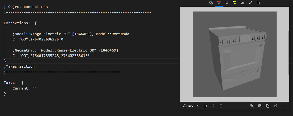

I'm developing a system where I need to load an FBX file that was generated from 3dsmax, then iterate through the objects, and export each individual object to an FBX file.
I think I'm close. This script is opening my source FBX file, iterating through the nodes and then writing out each one to a new file. The problem I'm struggling with is how to preserve the material connections in the individual FBX output files.
I followed along with the merge scene example as a base for this, and from what I can tell the issue is that as I'm iterating through the child nodes and disconnecting from the source scene/reconnecting to the destination scene it is making it so that nodes that are processed later in the iteration don't have access to the objects that they are connected to since the materials are shared amongst multiple nodes.
I can see this if I view an object like this for example, the first of it's type to be exported:
Connections are intact, materials show up in model when imported in DCCConnections are intact, materials show up in model when imported in DCCMaterial connections are not in ASCII, no material assignments when viewing in DCCMaterial connections are not in ASCII, no material assignments when viewing in DCC
The first object of this type is correct, it has it's materials and they show up as connections listed in the ASCII. The second object of this type has no materials assigned when imported into Maya. I confirmed that the ASCII has no material connections listed. Most of the exported objects are this way, missing some or all of their material connections.
I'm beginning to think that my approach is wrong. The next thing I tried was maintaining dicts of cloned objects and connecting them, but I'm getting the same result. I feel that there's a simple solution to this that I'm not seeing.

I found a solution to this today in case this helps anyone.
Since I only wanted to load a main source scene once and copy each object in the tree into it's own scene for export, I found it simpler to just create new materials for each node:
