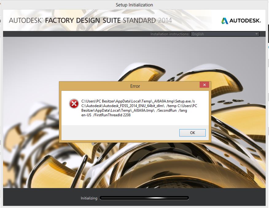

i wish to instal the trial of the factory design suite 2014 . If i start the install i always get the following error.
My machine is a brandnew i5 Notebook with win8 and 1600 x 900 graphics. I have administrator rights.

thank you for your help. It wasn't the solution of the problem. It seems to be the length of the temp-directory path. I changed it in my system to c:\temp and when i restarted the setup  it worked without any problems. Perhaps its a good idea to check out the field-length in your install. In my case it was 182 signs before the change which seems to be to long for the autodesk install-program.
Perhaps this solution will help. I found different posts with the same problem in other places while i was searching for help.
