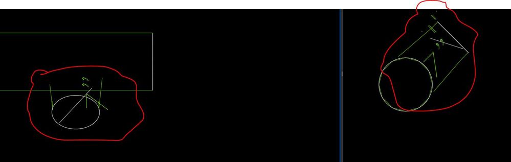

What would you do if the tap is rotated at a 45d angle?

I am not sure if I understand the question you posted.
The damper in any tap, should exist regardless of the orientation of the tap itself, since the damper is "hosted" in the tap.
If you have any further questions, please post them in a new thread.

conical tap at 45d in relation to round duct...damper handle not shown in plan viewconical tap at 45d in relation to round duct...damper handle not shown in plan view

Hi @Anonymous
Sorry for the delay, I was checking with my peers to make sure I had everything together before reaching back out with a response.
Thank you for posting your screen shot, and to answer your question the damper handle is still there.  What you are seeing is a graphical issue, and if you switch to any other view mode other than 2D Wireframe the handle will display as one would expect.
2D Wireframe - Plan view2D Wireframe - Plan view
Damper Handle Visible - use a display setting other than 2D WireframeDamper Handle Visible - use a display setting other than 2D Wireframe
Please let me know if this helps, if not reply back to this forum and we can continue to troubleshoot!
