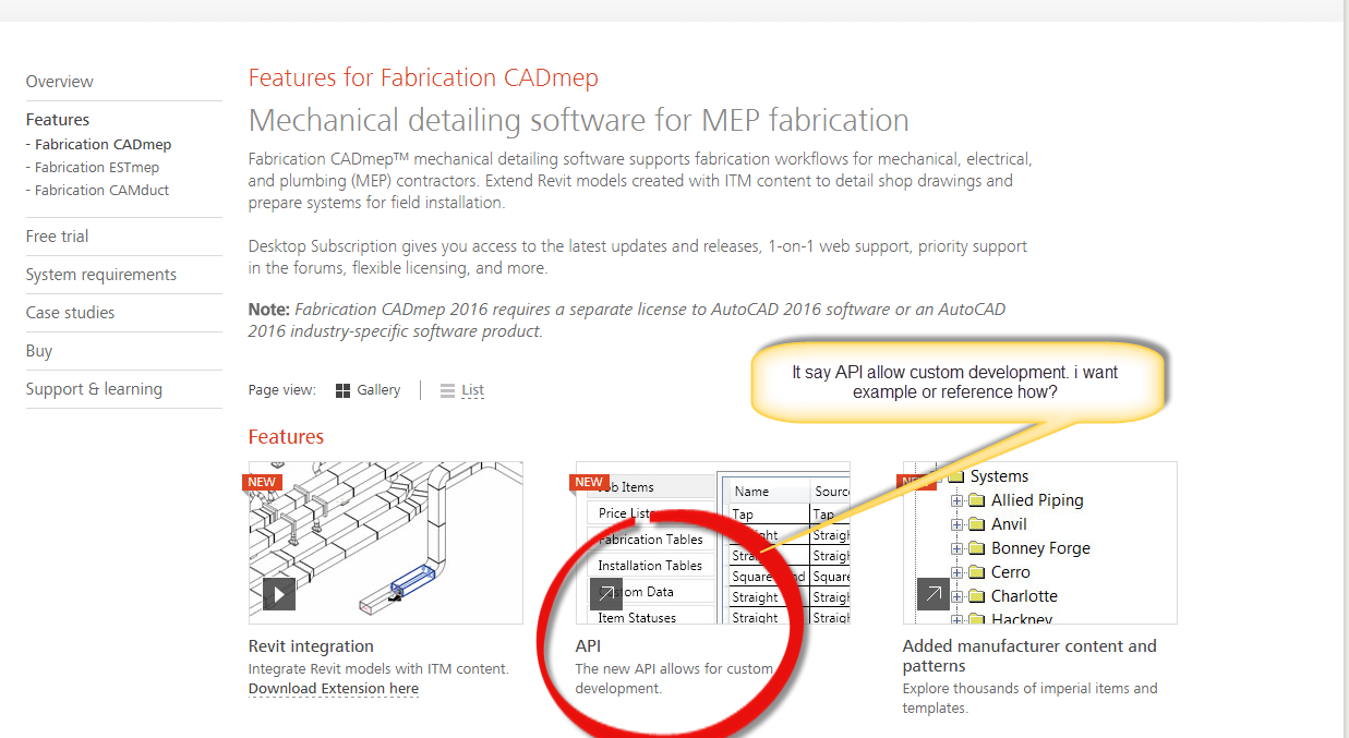

Guys if any one have any idea that can we develop Add-Ins like Revit in CADMEP. If yes please guide me to do or give me reference link so that i can try.

I would check out the Fabricaiton SDK doc.  It has a very similar api then Revit.  Attached is the Fabricaiton 2017 sdk document.

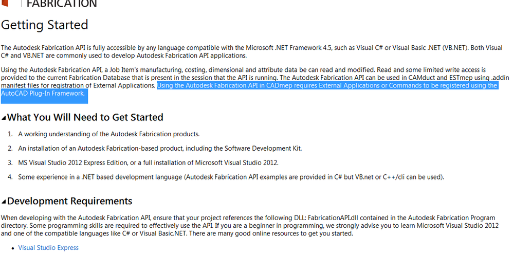

With the help of Fabrication.chm. I am able to create Plugin for ESTmep and CAMduct. But while going to create Add-Ins for CADmep i need some assistance. If possible please provide me step by step procedure for CADmep.

Look in this location on your computer C:\Program Files\Autodesk\Fabrication 2016\SDK.  There is an example that will show you what you are looking for.
