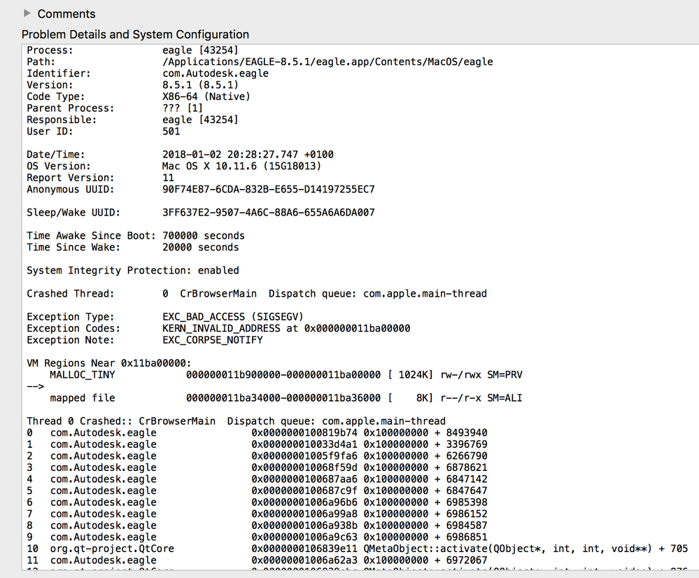

I have to agree about the "crashiness". The last few releases have been crashing quite a lot. Mostly after a lengthy editing session when exiting the app or when closing the schematic/board window with the (X) in the window chrome. Once or twice when actually routing the board....

Two hard crashes even before lunch today .  I do hit save every 5 minutes so I don't lose that much, but it's rather annoying. I guess (or at least hope) that you guys get the crash report data that is automatically sent to Apple - or do you want them uploaded to the forum?

jorge_garcia
Hi @mats.engstrom,
I think we need to explore this a bit more. If you want go ahead and post the crash report and if you can post a screencast of the crash happening that may help.
Let me ask, are you saving your files to a network drive or some sort of other setup?
Let me know if there's anything else I can do for you.
