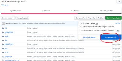

Hm, when I try to save scr/ulp's etc from you (i'm on a mac) it saves the files as "html". Then I try to rename them to .ulp or .scr but it seems the text is like made in html. I have no idea why but want to ask if you could make a zip of all your files you share there, if it's not too much work for you. I'm not used of github, maybe I'm missing the correct way how to download...
Message 22 of 26
C.Nicks
@Anonymous
You can select 'Download ZIP' from the main page of the repository. Or right-click the file from the list and select 'Save Link As'.
That will save the link with the original extension.
Note: All ulp and scr files are just text files with different extensions. If you ever have just the text of a ULP or script. Copy it to a txt file, using notepad or similar, then rename the txt extension to ulp or scr.
