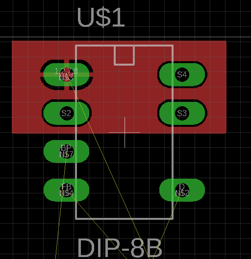

I just download the (powerint) library from eagle website but I face a problem when I try to use the (dip-8b) part, the pins 1,2,7,8 should connected together, in the schematic the designer assume them 1 pin and call them (S) but in the layout there is no connections between them and I can't connect them from the schematic

Hello @Anonymous,
Thanks for coming to our forums! Make sure that in the schematic you are making all of your connections using the NET command. You have to explicitly draw the connections from one point to another in order for them to be connected. Looking at the picture it looks like you just named the net 1 2 7 8, which won't work. You have to draw nets between the pins.

thanks for reply,
the library designer assume the pins 1,2,7,8 as one pin as shownpowerint2.png
I make a small change in the symbol and I think it's working nowpowerint4.pngpowerint3.png
