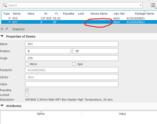

First, to replace a device, I have to identify the matching device in the "managed library". Unfortunately, after clicking on a component in Design Manager, it's not immediately obvious, which device I have to select in the library as a replacement. The "device name" in Results list and Inspector is empty most of the time, see screenshot:
Design Manager, unmanaged componentDesign Manager, unmanaged component
I have to select the device on the board and right-click "open device" to see the name of the device (for the component in the screenshot, it's "ML20"). Only then I can click the "replace component" button and search the device in the "managed library".
Second, after each replacement, the Design Manager's Results list is cleared and I have to do the search again:
Design Manager: empty listDesign Manager: empty list
