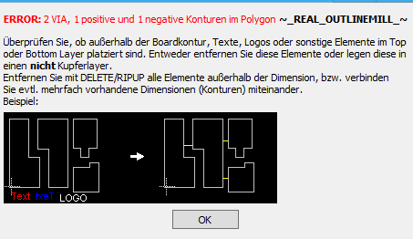

bkgoodman
I tried it and I get this. I don't speak German - no idea what it means...
Message 7 of 10
Andreas.Schimke
Hi bkgoodman:
The script state that it found things outside the board dimension. Things could be: text, logo or parts.
It is also stated that the dimension should be checked if the board has no open gap on a side.
Regards,
Andreas
