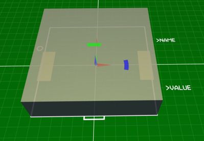

Almost 2 years later, I see the same issue as the original author of this question: After editing the 3D package of a component using the "EDIT3D" command, the device in the library does not contain the 3D package. I only see the grey box that is assigned by default to all devices, see screenshot of Library Editor's device view:
Library Editor, Device viewLibrary Editor, Device view
Clicking "Create new version..." in Library Editor does not change this.

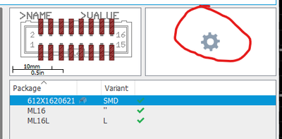

Mind you, this workflow does not always succeed. I followed this workflow for another device and now the 3D package looks like a cog wheel:
Library Editor, Device View, cog wheelLibrary Editor, Device View, cog wheel
This library management is baffling me.
