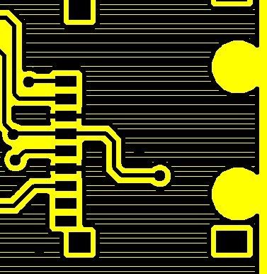

My manufacturer is asking me to remove those lines from the ground gerber layer
Nx7TY
I've been searching information about this problem and I've found nothing, I don't know if it has a specific name or it isn't a real problem
It's a problem of the gerber file?
I'm using Eagle 8.3.2 and GERBER_RS274X as device output
The polygon properties:
polygon pour: solid
isolate: 0
rank: 6
Orphans: uncheck
Thermals: check
I've edited this last options, and none of them seems to solve the problem. I've also selected the polygon pour as hatch but instead of line I see dots
The cam file I'm usign to generate the gerber file is this
I'll really appreciate any help

It is happen me with all the gerber files, for example this file from sparkfun: https://cdn.sparkfun.com/assets/learn_tutorials/5/0/7/esp32-thing-v10.zip
I open it, and then use this cam file to generate the gerber files: http://docs.oshpark.com/resources/OSHPark-2layer-Eagle7.2.cam (I've use others too). In the case of that file, I just generate the files, I don't edit anything. In the cam panel I only change the destination and press the "Process Job" button
I finally use gerbv to visualize the file: http://gerbv.sourceforge.net/
At the beginning I thought it was a problem of the viewer software, but now my pcb manufacturer is asking me to fix that problem so I asume it's not that.

I can see the issue when I load this in gerbv but currently I can't replicate this with the CAM processor in v8.3.2 and have never seen this before either.
The way EAGLE draws the ground plane is with rasterising it with wires of the width specified in the polygon polygon properties. The only thing I can think is there is some weird rounding error causing a gap to appear between the lines used to create the fill. Can you tell us exactly what line width is set for your polygon please? It might be that changing this width setting slightly will cause the issue to go away.

I am sure that this is a problem of the Gerber viewer and I assume that it is a problem of the currently chosen zoom factor. I heard similar requests of users from time to time all over the years and it always turned out not to be an EAGLE polygon issue.

At this moment the polygon width is 0.5, I've incremented thinking the same, I started with 0.3
@RichardHammerlI've also check in one more viewer and I had the same result. The person who I talked to, told me she had others gerber files with ground planes and they don't show the gaps. If that is a problem of the viewer I need to prove that to her

Same results using gerb274x.cam.
I've just downloaded a gerber file from github and I have open it in the viewer software, it doesn't show any gaps, so I may say it's an eagle problem not the viewer.

Looks fine in Viewmate. I do still think the CAM processor should be updated to use the gerber extended format polygon features. They were added in 1991 to allow defining polygon area fills without the need for "painting".

I've just talked with them and they are visualizing the gerbers with Altum and kicad and both software has the same problem. I've tried creating a new board with two components and a few wires, with a ground plane and I get the same results.

To add to the confusion, if I run the CAM processor and create the gerbers from this project and view it in gerbview (from KiCAD) I see the lines, if I view it in gerbv then it's perfect with no issues. Yet the gerber layer you uploaded earlier showed the lines for me in gerbv....

After all this days searching for a solution, I finally did it. I've imported my project in KiCAD, without much effort I've exported the gerbers files from there. So I can say that the problem was eagle.

@Anonymous This type of error could have been caused by a defective eagle.def file, I have no idea how that could have happened in your case but that is the only thing I can think of that hasn't been mentioned so far in this thread.
