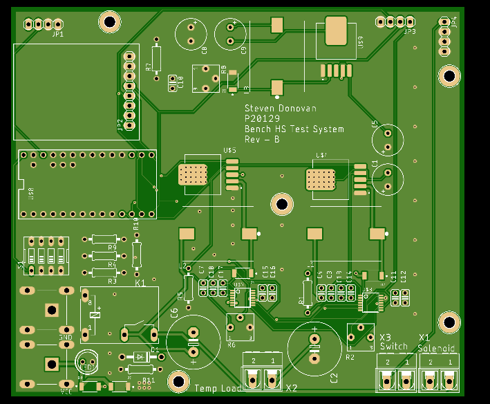

Hello all,
I am making a four layer board and have ran into an issue I have never had before. When using the 'generate CAM data' button in the toolbar, the Gerber file misplaces my silkscreen. Any fix would be greatly appreciated!
Some additional information: I am using sunstone 4 layer eagle DRC rules. (I have used them in the past without this problem)

Try a different viewer. There are some online viewers that are known to produce utter rubbish.
I use gerbv but there are several other free Gerber viewers available.
I discovered something was wrong when I went to purchase the board from JLCPCB. Unfortunately, I don't think it is the viewer.
JLCPCBJLCPCB
one-of-the-robs
OK, check the settings you get from those DRC rules and in the manufacturing tab. It looks like the silk screen Gerber is mirrored, which I can see no good reason for as it's a top-side one.
I messed around in the CAM processor for a while and also tried loading different DRC rules. For some reason when I have a 6-Layer board everything comes out okay. Then I manually remove the inner two layers while still using the 6-layer DRC and then the silkscreen disappears similar to before with the 4-layer DRC I was using. I am not sure why I am having trouble with the silkscreen on 4 layer boards specifically. Below I detailed the steps that ended up fixing it. Note: Vertically mirroring the 4 layer DRC silkscreen did not fix the problem.
