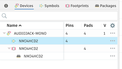

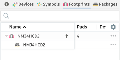

On Fusion 360, I created a new library. This library contains one device called Audiojack. I created a symbol called NMJ4HCD2, a footprint called NMJ4HCD2 and a package associated with the footprint also called NMJ4HCD2.
I understand that I have to assign a footprint to my symbol connected to my device, but I am not sure how to do that. Below, a few images showing what I explained above.

I deleted the device and added a new one from scratch. After doing so, it showed on the bottom right of the page a button to add the footprint.
Now I am able to have my device ready in my new library.
Thank you all !
herr1X78BK
For all those who have the same problem. Open the device and type "package" in the command line. A new window will open where you can connect the footprint to the package. Then you can connect the pins inside the side panel.
