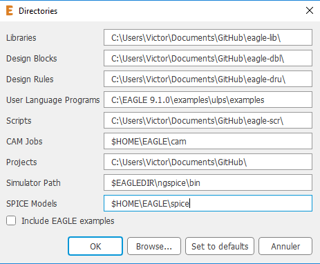

Whenever I try tools such as "renumber parts" or "statistics" I get the following error:
Can't find 'C:\EAGLE.ulp'
I run eagle 9.1.0 premium installed in C:\EAGLE 9.1.0\
Below is the directories set up:
What's wrong?
Thanks!

Hi Victor,
That seems weird.  Can you confirm that there is a ULP named eagle.ulp in the folder listed in the ULP directory field?  Maybe there's some weird non-printable character that got into that field entry?

Hi @Anonymous,
I hope you're doing well. This issue has to do with the fact that there are spaces in the path to the ULP. We have fixed this issue for the next release 9.2.0 which will be out within the next couple of weeks.

Is there a work around?
jorge_garcia
Hi @labumm,
Move the ulps that have the issue, to the ULP folder in Documents> eagle. That should avoid spaces in the paths and allow the ULPs to work correctly. Give it a try.
