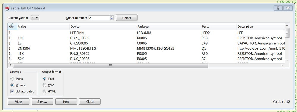

Is it possible to get a BOM for each sheet, or separated by sheet?
I couldn't find a way to do it in Eagle, and none of the BOM ULPs had this feature (but I might have missed one).

Eagle Central is no more. In case anyone is wondering I used the ATTBOM ULP to export a BOM into LibreOffice Calc (with the HTML generated with ATTBOM), then sorted in Calc by SHEET.
It's a bit cludgy but works. The biggest hassle is concatenating same-value parts into one line.
It should be fairly simple to mod the existing BOM.ulp...
[several hours later]
I meant to take a brief look to see how easily it could be modded, and just ended up doing it. It's posted here: https://gist.github.com/THX2112/4977684786ab60365645962ccf29ec1a
It has a problem with ICs (counts invoked power pins as an IC). Maybe someone who knows what they're doing can take a look at it.
