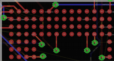

Does anyone have any suggestions for BGA escape routing? Between autorouting/hand-routing I haven't been able to make much progress.
My main issue seems to be that I can't wire between the BGA pins on the top layer. This suggests a package/footprint error but I couldn't find anything.
Here's a picture as reference - right now, it's impossible for me to get the +3v3 pin at c9 anywhere I could make a via. Intuitively I should be able to route down to the center of the package and put a via there but Eagle isn't letting me. My min trace width is .005" while the pin pitch is .008" (so it should be able to route between pins without a problem).

I think the problem is your DRC setup.
You really want your vias fanning out in a diagonal fashion from the pads.
However your pin pitch looks very fine and your will likely need to use micro vias to fan out that BGA, although that will come with additional cost during fabrication.
I typically try to use BGAs with pitches no smaller than 0.6mm as that works well with many fab houses.
Other people may have butter suggestions but I think microvias might be the best option for a chip with a pitch that fine.

Sorry, I mistyped the pin pitch. The BGA has a pitch of 8mm not 8 mils (I don't know what I was thinking).
Hmm it might be my DRC file - I'll double check my pin/wire dimensions. But if I set my wire width to something really really small (say .01mm) Eagle still won't let me route it through the pins.
Regardless, thank you so much for the advice on wiring diagonally and for the screenshot, once I get this working I'll follow your example. Thank you!
