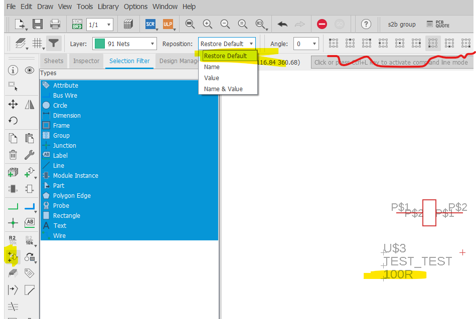

16 条消息(共 19 条)
mtl_asm
已接受的解答
hi,
i found some new info about the "Reposition Attributes" button. If you click on it you will see in the menu bar now there is a menu with 4 options.
Restore Default
Name
Value
Name & Value
If you have the "Restore Default" option, it acts as the "Restore Position" option when right clicking on a part.
As you said earlier, clicking the "Reposition Attributes" button with the other options selected will reposition the name/value designator (according to the button to the right of the menu).
Also it works with group. So you can select all the parts you need to change, then select "Reposition Attributes" and change the option to "Restore Default" then right click and select "Reposition: Group"
Then it will change all at once.
I checked with 9.6 it seems to work, just the reason both buttons worked the same for me in my previous post, and why for you it makes the name/value move  is likely explained by the selection in this "Reposition" box/dropdown menu. When i pick some other option it behaves as you described.
If you look at the .brd in xml, basically when you call "update all" from  the libary menu after modifying the part as we described previously, it will add the "attribute" sub element to the <part> elements, but it does not add them to the <instance> elements (which seems to be necessary for them to render on the screen). Once you use "Restore position" on the part it does add the "attribute" sub element to the instances. Maybe they can update that in the future, or maybe there is a reason they don't. If you add a new part as you said earlier, the extra attributes do show up, and when using "add" the attribute sub element is added both places in the xml right away.

17 条消息(共 19 条)
grahamUTKMN
You sir, are a hero!
That's sorted it!
That has saved me soooooo much time and stopped me going slightly mad while I'm working from home all on my own.
