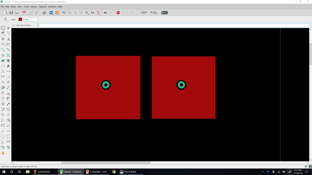

The answer is how thick the lines are that form the polygon. On the left, the polygon line width is 0.2mm, on the right it is 0.1mm. The second picture shows the same thing but with the layer specified as a hatch rather than a solid. This makes the effect a bit easier to see. I have not done any work to see if these widths hold true globally or if they are related to the pad size of the via - which in this case is .7mm

I just experimented a bit with your brd file, and I think it's a bug, but a very concealed one. And an old one too, Eagle 7.7 behaves the same. The issue arises when width and isolate are both very small. If you make one of them sufficiently large, you get a (nearly) round cutout.
For example with your brd file, the issue is still there when width=14mil and vanishes when width=15mil (and the resulting isolate value from DRC/netclass = 5mil).
So I suspect the problem is a rounding error in an intermediate calculation result in the program. Increasing the precision (float to double) or changing the sequence of math operations (multiplication before division) might already cure it.

I do lots of very tight 4 layer boards with 4/4 and even 3/3 copper and have never found octagonal setbacks to be a problem, so I never tried to fix it until last night, just to see if I could.
Regards -
Message 17 of 22
iquacker
Making the line width bigger, makes the setback go round.
