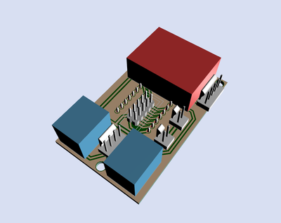

I did I massive redesign (or so it felt at least). I have limited space in the housing so had to get creative. I had to put some components on both sides, but I guess there is no reason why I couldn't do that, right?
(ecad.io makes these great 3d images!) the red block is a part unknown to their system, actually a ready made pcb by sparkfun, the blue blocks are the relays
I think I managed to do a reasonable job. I've added the diodes, as close to the relays as possible. Is my placement correct?
Just some more in those capacitors...

sorry, not much time for your file (none), just notes:
I prefer the diodes lying down, not standing, you won't be able to solder those anyway 😄
, also, the diodes can be small, even small signal schottky diodes.
well, the diode is just "any"
The capacitors. Have a look at your mainboard or other piece of well made equipment for inspiration. IBM original equipment for megalomanic interpretation.
I have no doubt it would work without those capacitors, but learn it in this "demo" beforeyou start using parts which would simply not work without it.
And... start disassembling things around. EVERYTHING. One by one.

jorge_garcia
Hi @Anonymous,
You did a great job! It's OK to place parts on both sides of the board and this is done quite often. As far as the coupling capacitors go for this design you can get away with one at each active component, however for high-speed or high-power designs @Anonymous is correct you might need multiple capacitors in parallel.
The placement of the diodes looks pretty good, but I'm sure you would rather lay them flat.
