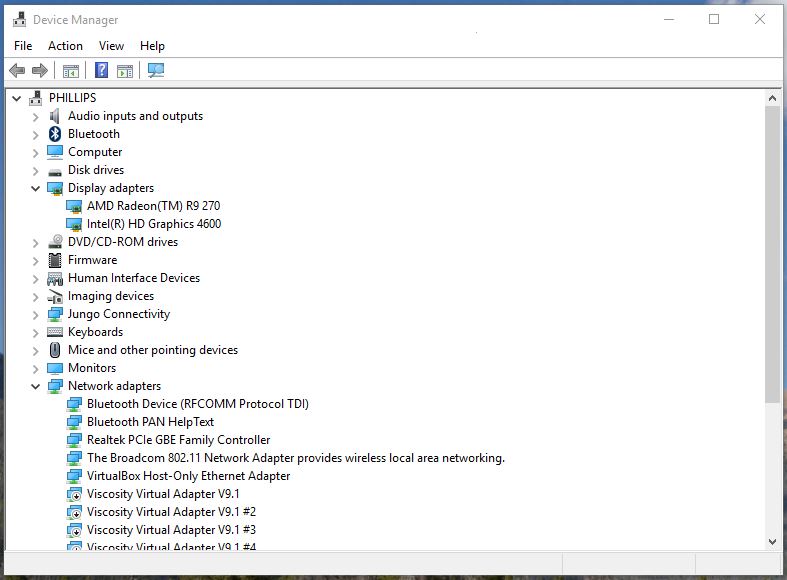

Hello, after upgrading to Eagle 8, eagle.exe crashes on startup. Have used E6 and 7 fine for years, new Eagle 8 just doesn't work for me. Generic screenshots are attached. Tried reinstalling a few times to no avail; any other advice? Using this for work so I need to get this fixed yesterday...

I hope you're doing well. So far all of your answers to the questions I have asked are checking out correct. Now we have to go deeper, do you have any special network configuration? Anything beyond a basic home internet connection is open to discussion so please let me know.
What type of Graphics card are you using? In another post a user was able to fix his startup issues by updating his video card driver.
What anti-virus do you have installed? In the past Kaspersky has not been too friendly towards EAGLE so disabling may help us see if there is any interaction there.
Lastly, in the past EAGLE and a program called RoboForm did not get along at all. If you have an install of this program can you disable it temporarily?
Any and all information you can provide will help us figure out what is going on.

Jorge,
Network connection: I am using this on a work PC although it is a small LAN not unlike a basic home network setup. We have two licenses where the Engineer sitting beside me is able to run Eagle just fine.
Graphics: Radeon 270. I disabled this as well as updated and it seemed to have no effect on Eagle.
Antivirus: Windows defender. I disabled this and it seemed to have no effect.
RoboForm/Ad-aware: not installed
http://autode.sk/2kmZ37X
Hopefully you can follow this screencast share. It is public but I haven't used screencast before...

You have an AMD graphics card which in another thread updating the drivers fixed the issue but not in your case.
If you can't get a crash report, could you give me a list of the background processes running on your machine?
Thank you for the screencast,
You mention the engineer next to you can work just fine. Is he using the same type of hardware you are using? If you are using the same hardware then seeing what is different between both machines may give us some clues.
Thanks Jordan for your insight we are working as hard as we can to figure this out.

Lavasoft was running unbeknownst to me (using an hand-me-down computer) as "web companion" in prog/features. After uninstalling, Eagle now works. Sorry, this was frustrating for me. Glad it works now.
