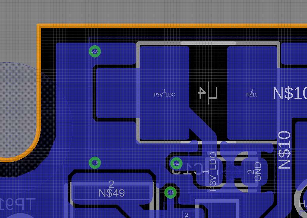

I made a board with Eagle, which was sent to an EMS for manufacturing prototypes.
when I received the PCBs, I found a short-circuit, because of a difference between my brd and the generated Gerbers.
Did you ever have this problem ? Is in a problem with the package, with Eagle, ... ?

I checked my Gerber files with Gerbview. The screenshot is the view of the bottom layer in Gerbview, where we can see the problem.
Message 6 of 12
one-of-the-robs
That looks like one of the polygon flood fills is not respecting the presence of L4 when the Gerbers are generated. I don't know what would cause that but it may be worth experimenting with the polygon's settings - particularly the "rank" and "isolate".

The polygon settings are something to look at, you're right.
It's a 6-layers PCB, I control my BRD file, but not the Gerbers. I don't think I should have to check Gerber files, it's a pain and I want to trust the BRD -> Gerber conversion. But obviously, I will for this kind of problem.

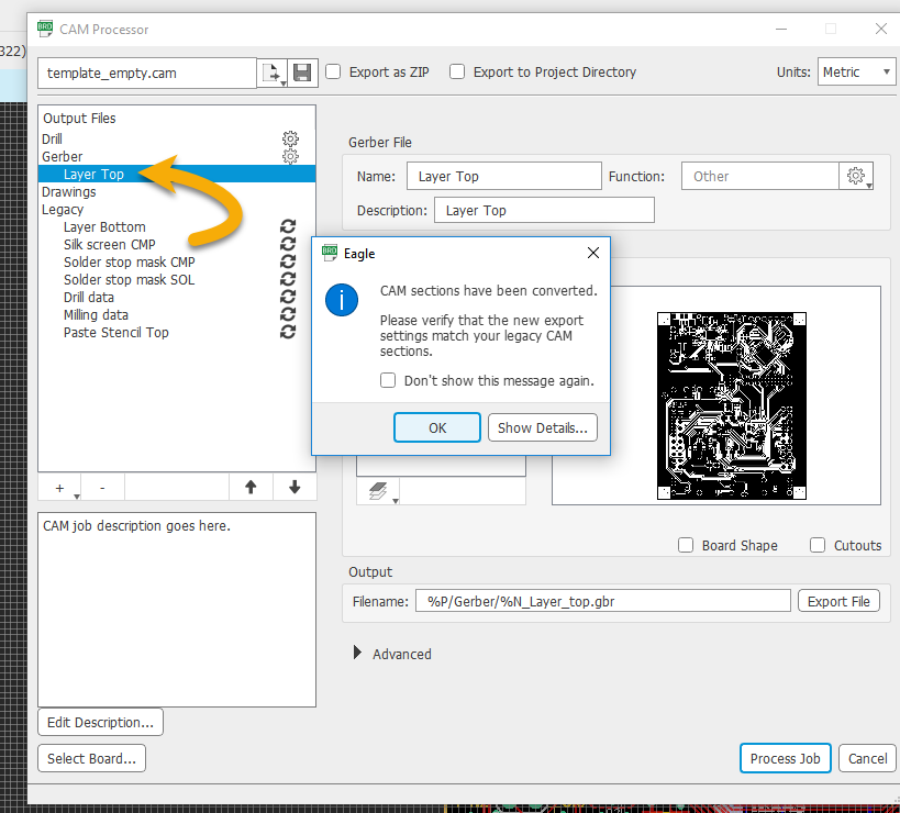

Hi thibaudZ7MQK,
Thank you for participating on the Autodesk EAGLE forum. Apparently a legacy CAM job was used to create the Gerber files.  This did create some issues with the polygons on the board.  This has been repaired for our next release. For now, in the easiest way to solve this in EAGLE v9.0.1 is to load the CAM Job in the CAM Processor, then double click the legacy sections to convert them into the new format. Processing the Gerber file using the new format will be able to handle the polygons the correct way.
FYI: We tested a few legacy CAM jobs in the next release of EAGLE, they worked just fine.
