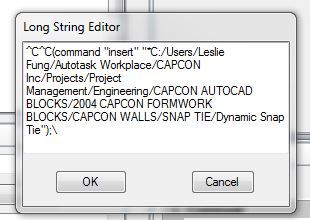

I have created a ribbon button to insert a dynamic block from my company's cloud based server. When inserting the block, it does not insert at the base point that is defined in the block. Basically, it flies out into the model space and I don't know why. The photo is the string of the command to insert the block. I understand I can have the block insert at 0,0. But I would like to be able to insert it from the defined grip inside the block definition. ANy help would be appreciated,thanks. Long String_Insert Snap Tie.JPG

Is that the actual file that the command is directed to insert?  If so, then the reason the block is off in space might be because it is almost 2400 units away from the origin in that drawing.  Browse to that file, open it, move the block so that the basepoint of the block is at the origin of the file and give that a try.  Alternatively, you could WBLOCK the block to a block file of the same name and place that block file in the appropriate location in the directory so the command inserts the block file instead.

I understand tool palettes are better, but I'm being to directed to proceed this way. I will try your suggestion.
