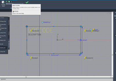

Make two visibility states. One which will be used to hide the box. Go into that visibility state. Select the box and then click on the icon in the image below

h_s_walker
If you use extra visibility states to "Hide" the rectangle the other items of the block will still print
