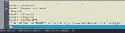

I've got to the min. 7:36, all perfect. But I can't do the next step. It is not possible for me to change the selection to Rotate1. Please see my PhotoPict1.jpgPict2.jpgPict3.jpg

Libbya
If you set the system variable BACTIONBARMODE = 0, you will get the option during creation of the rotate (and scale) actions.  With BACTIONBARMODE=1 you do not get the option during creation but you can select the action, go to properties, and change the Base Type to 'independent'.  A new grip will appear at the center of the rotation parameter.  That grip can be moved wherever you want the center of rotation.  That said, you will need BACTIONBARMODE=0 at other times in the process in order to add the independent rotate actions to the selection set of other actions, so it might just be easier to set it to 0 for the whole process.
