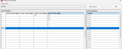

Recently, I have updated from AutoCAD Architecture 2022, to 2026. I heavily use lookup tables to create my dynamic blocks. they have changed how you can edit the tables, and I'm looking for a fix/way to revert the change.
Normally i would be able to navigate via keyboard and just type the value I want (I use 1'-0" increments) and it would autofill what I type, I.E 1 would be 1'-0" and so on.
for some reason now, if you type that way it will put in values you should not be able to type in, like 1" instead of anything else. I can edit and fill out these tables manually, but it takes a lot more time and effort.
below is an example of what its doing.

I have 2024 installed, and if you have an increment set, it lets you write whatever value you want into the lookup regardless of whether or not the value matches the increment.  I don't currently have any earlier versions installed so I can't check, but I believe it has always been that way.  I believe the autofill has only occurred when the parameter has a LIST of values, not an increment.

sorry i misspoke, I have it set up in a list, but its goes up by a 1'-0" per. they are dummy parameters that are just their to work in the back end of the block. I'm not sure what version this changed in, i have 2022, and the 2026 installed right now. I'm currently trying out 2026 to see if anything weird happens before fully switching
