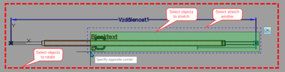

I would like to as you for support. I would like to make dynamic spindle block  with  only one movable polar point. I can make the same block with linear parametres but I would like to use polar parametres, but I cant figure out how to set up all parametres to get the same behaviour like with linear parametres. See attach.
Thanks a milion.
Radek

In the sample drawing you posted, it appears that you have only selected five objects to stretch. You might need to chain some actions for the portions that need to be moved some distance other than 1x of the distance selected. Adjusting the stretch window and the selection set should resolve the rest of your request. I've attached an annotated image showing the new selection set but it does not take into account the chaining needed for the half distance of the "block text" portion.

Attached my suggestion.
(I'm not sure about the Blocktext attribute. What exactly do you need? )

Thank you for your support. The block just need some tuning. The mtext should be rotated too. Is it possible to get the same action with the inserting point? Can you briefly describe the steps you did when you design the block? I would like to use the same logic in other blocks I would like to design. Thank you in advance.

Maybe I wrong interpreted your "get the same action" issue. I thought, you want to grab and drag the left end of the mechanism in the same manner as the right one to stretch and rotate around the opposite end.  >>Click<<
Also I am/was unsure with the offset rectangle near the Attribut. In your linear example above this rectangle moves with the tube without a relative movement, in @timothy_crouse 's solution it slides along the tube and changes its relative position. What do you need really?
My suggestion uses the Parametric. I drew a line (3198 long) whose ends can dragged with a polar parameter. All other geometry is joined to this line using using geometric constraints.
But if you are happy with timothy's solution it is not worth the  effort to create a screencast. (Let me know if you want it)
