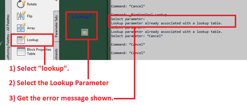

First I added the lookup actions to the lookup parameter on the pallette.  Then I placed a lookup parameter using this same pallette.
Then I attempted to add the two lookup tables.
Don Ireland

When you place a lookup parameter using a tool that has had two lookup actions added to it, it automatically places the two lookup tables into the block already associated to the lookup parameter.  If you are not seeing both tables, then you need to change the system variable 'bactionbarmode' to 0.

Thanks. I made the setting change. And tried placing a new parameter (after making sure it was still set to put two lookup actions and it was). I still only get one table.

It shows both tables there when bactionbarmode is set to 0.  One of them is Lookup5 and the other is Lookup6.  They will both show up with bactionbarmode set to 1 once you have edited them so that they are different from each other.  Personally I prefer to keep bactionbarmode set to 0 unless I am selecting all linework/parameters and don't want to select the actions.

I clicked on the little lightning bolts, went to properties and found "Lookout Table" there.  That gave me access to the two tables.

When bactionbarmode is set to 0 you can just double-click the lookup action and it will open the table.
