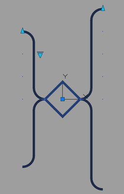

Hello everyone, i'm new at the forums. My pleasure.
I know the tittle may be a little complicate, so i will try to explain my block and what i need.
This is my block
As you can see, i have one stretch in both sides of the block, let's concentrate in just one because the other one is a mirror.
If you pull the stretch upwards, the lower part will also stretch in the opposite direction, everything cool here.

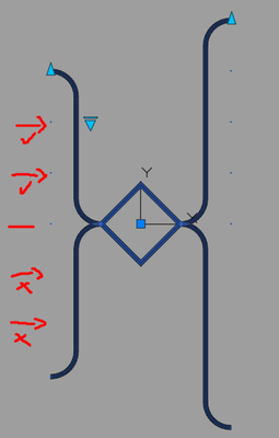

I wanted to add a point to array along the stretch, so I did but this is what happen
As you can see, the point will array along with the stretch but only with the superior stretch, not with the lower part.
So, does anyone know how to create a "double array" linked to a stretch?
What i need is to have the same behavior in the array parameter that i have in the stretch parameter, same distance, in both opposite directions.

Here you go:
Thank you, didn't know how to use the "Chain Action" properties correctly, now i know haha
Once again, thank you very much, very useful video
