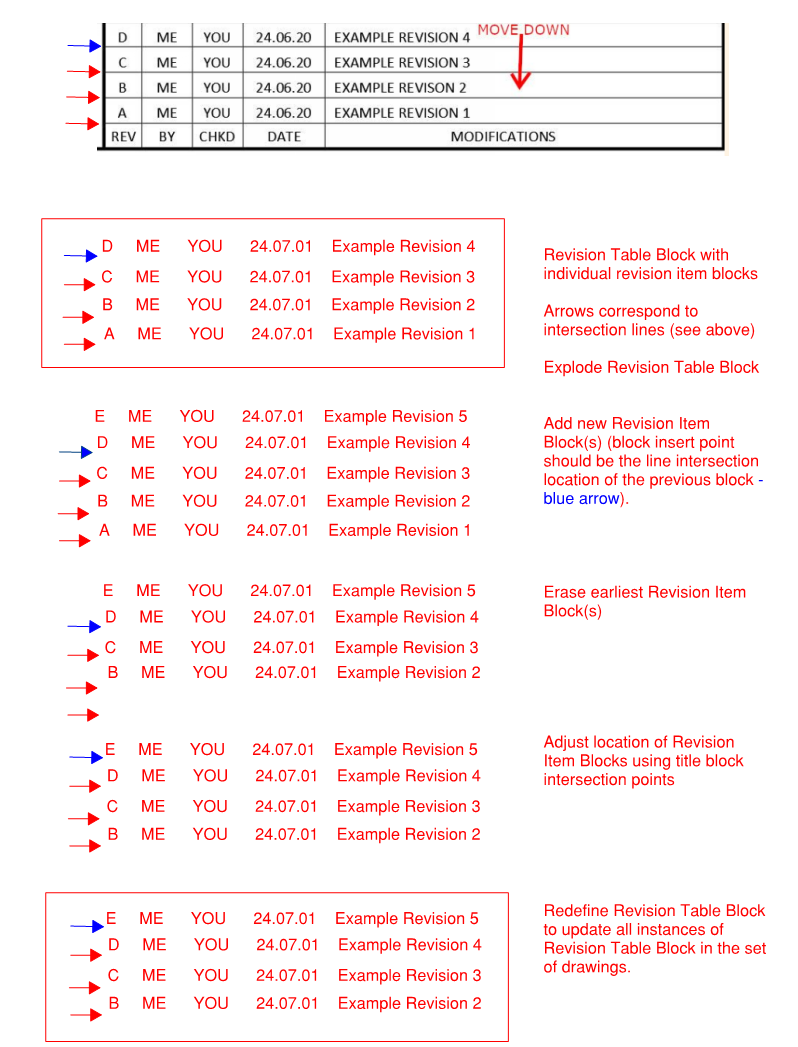

Sometimes you can save a lot of time and effort by things the simple way.
Since you currently destroy any history beyond the last four revisions, I will assume that they are not required and the actual issued drawing files will provide the history if needed.
I would  attack the problem by using simple nested blocks instead of using dynamic blocks. The result is much less work than creating and modifying the dynamic block method shown above.  The blocks being "removed" could be placed on a no plot layer and turned off if you wanted to keep them.

If multiple drawings will have the same revision text, then nesting blocks would be useful to update all drawings. If the revision block is valid for only one drawing, nesting blocks would not be necessary.
Unless one has a crystal ball, each drawing revision requires changes to the lookup table (Rev, By, Checked, Date, and Modification). Modifications would be easier by editing simple attributes than by editing the lookup table and visibilities in a dynamic block.
Currently the OP does not appear to be saving the earlier revision lines.  If they are no longer needed, they can be easily erased with standard blocks - with a dynamic block retaining all revisions, it is more difficult task.
The number of drawing revisions that will be made is unknown. A dynamic block requires a fixed number due to visibility issues.  Adding more revisions to a dynamic block means a user must deal with visibilities and measurements.
If multiple users need to update revisions, some may have to learn how to modify dynamic block lookup tables (see OP responses above) but most would know how to modify block attributes.

After closely following the video, I have to admit your method was faster under the conditions presented.
As far as adding revisions (more than the default placeholders of the initial block),  editing the block is still required to get the correct revision visibilities and positions.
The simple block configuration does have its place - some companies only show revisions that occur in the drawing. For instance,  drawing 1 (shows revisions 1,2, and 3) , drawing 2 (shows revisions 1,2, and 4), and drawing 3 (shows revisions 2,4, and 5). This scenario would require editing the attributes of each dynamic block to show all three lines stacked and without spaces between them. In my opinion, this is a case where the simple block configuration would be faster.
I do have a suggestion for your block - the "Y" position should be the same for the first four revisions. This would position the revisions starting directly above table heading rather than leaving blanks between revisions and heading.
