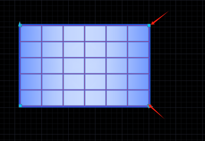

Hey,
How to hide the array grips? Because it's easy to drag the array grips by mistake when i drag the stretch grips.

In the block editor select the grips and delete them.

@Richard_Yankee Change the ringed value to 0

Richard_Yankee
But what's going on with my block?
j.palmeL29YX
Right click on the block reference and Reset the block ...
