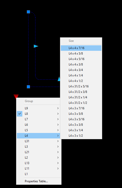

Hi Falconbird,
I think you want to result per my attached dynamic block. I have completed you block based on the question you asked.

serkancavuslar

awesome block, thank you!
