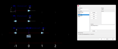

I’ve run into an issue while working on a Dynamic Block, and I hope someone can help me with this. The goal is to create a ruler line that I can stretch using an array, so multiple rulers are created. The distances between the rulers can vary (e.g., 500, 600, 700, 750, or 1000 mm). The stretching works fine, but the numbering of the rulers isn't working as expected.
I created two arrays starting from the zero point, so for example, you can display only the range from 120 to 140. This way, you can easily adjust which part is visible, without using an Xclip. If you were to fully draw the ruler and use an Xclip, the base point and block table would be at the same location, which makes it less flexible to adjust.
Here’s what I’ve done to start the numbering:
  • In the block, I went to Field.
  • I selected an object in the Object tab and linked the parameter Distance3.
  • I then clicked OK, reopened the text, and entered the following formula:
    (floor(@Length / 500)) + 1.
Additionally, I want the text coming from the Field to have no text background, so only the numbers are visible without any background or frame.
Does anyone know what I might be doing wrong or how to solve this? Thanks in advance!

>>Here<< I have shown how you can number an array of "markers" (here the vertical lines).
Regarding to your current issue you have the problem, that it works only for one given distance between the markers (here 500). This value is a constant part of the formula
and can not be substituted by a variable.
If you need different distances between the markers (e.g., 500, 600, 700, 750, or 1000 mm) mabe you can do it with some visibility states?

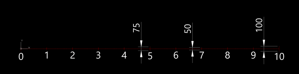

I’ve successfully implemented the attribute with the field, and the formula is working just as I want. However, I’m encountering an issue with the field marker (the gray background). Even though I set FIELDDISPLAY to 0 and save the drawing, other users still see the marker when they open the drawing on their computers.
My question now is whether it's possible to make the field background permanently transparent, so others don’t see the marker when they open the drawing. It’s fine if the marker remains visible within the block, as long as it is hidden outside the block.
Additionally, I want to adjust the horizontal lines, which are currently 50 mm long by default. I want them to have different lengths based on an associated number:
  • 100 mm long for numbers like 0, 10, 20, etc.
  • 75 mm long for numbers like 5, 15, 25, etc.
  • 50 mm long for other numbers (such as 1, 2, 3, 4, etc.).
All lines should be drawn from the center, so they should not shift left or right.
Now, I have an additional question: I don’t want the length to start from 0. For example, if I only want to show a specific part of the line, such as between 120 and 140, the line should stretch from 0 to 140, which takes up too much space. This is not ideal as it makes the display too large. How can I adjust this so that the line does not stretch to the full length, but only shows the specific range?
