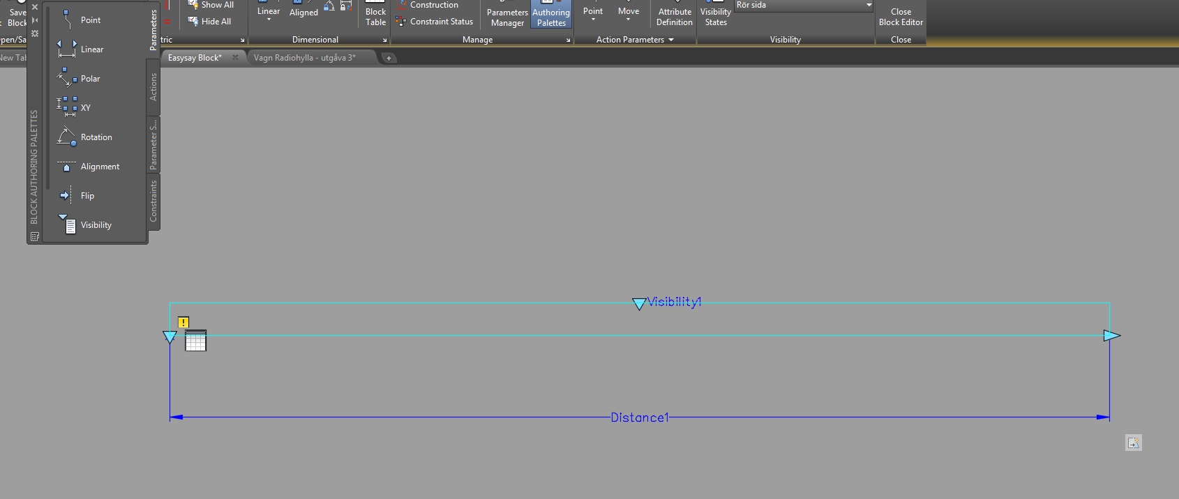

We have very very simple rectangular blocks and these reqtangulars is placed in a drawing with many different lengths.
These reqtangulars represent tubes that will be cut in different lengths
When a drawing is ready we maybe have 30 different lenths and each length could exist in the drawing many many times
I would like to get a drawing table that shows amount of tubes and the cutting length (Distance1)
How can I get a table with a list of this?

try DATAEXTRACTION
kasperwuyts
Dataextraction is indeed the way to go.
