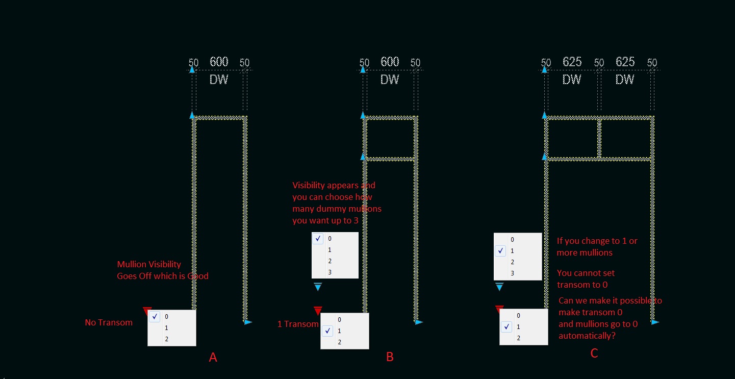

Please see attached picture and block and see if it is possible to make lookups related to each other.
In this example, I want "Number of Transom" lookup be set to 0 even if we set "Number of mullions" to one so it jumps to zero too.
I am getting better in Multi-lookup. There were no errors after setting up the lookups in first go. Thanks again Libbya for this lesson.
Cheers,

On the Lookup Input table of the Bridge double lookup, on the 0-0 row, under the Position1Y column, I changed the value(s) from '0' to '0,1,2,3'.  That way, regardless of what the mullions is set to, if the transom is set to 0, the transom turns off.  The number of mullions does not jump to zero, though.  It is remembered and displayed again if the transom is set to 1 or 2.
