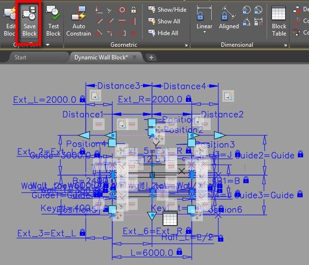

13. Back in Block Editor, click Save Block.
14. Warning message block is not fully constrained.  I am aware of this and it is OK.  So click Save.
