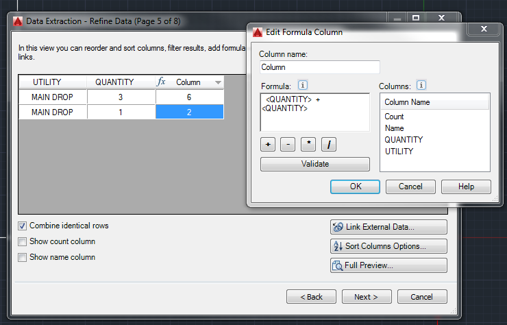

Shouldn't the table look like below?

MMcCall402
In the pic, the column for the "Quantity" attribute is hidden. As this value changes from block to block it makes a unique row for each of the unique values and only combines rows then the value is the same.
