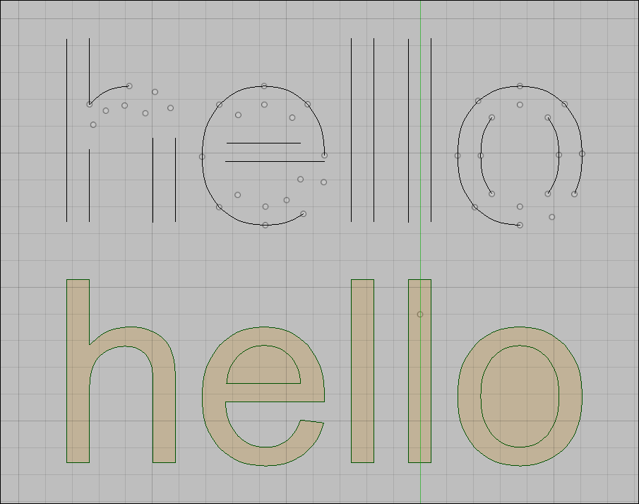

I brought up this bug quite a few months ago, but it is still present.....any word on when this will get resolved?  It is very easy to re-create:
  • Start a new Design
  • Sketch on any plane
  • Select Sketch --> Text
  • Use default 10mm text and default font, type the word "hello"
  • Explode the text into sketch curves
  • Zoom out a bit so that the text is a bit small on the screen.
  • Drag a box around the entire word
  • ....find that not everything is selected...something about the view somehow affecting smaller "hard to see" segments?

Hi, selection works in F360 a bit oddly, it pick entities that are "well visible", if you zoom in it will work fine, if lines are to small it will ignore them. Luckly ther is a simple work around,
in select tab go to selection filters and check Select Through. Now it will work as it should, it will select all lines even the smallest one. Just keep in mind that you have enabled this option and if your scene get crowded, you'll be forced to hide unwanted objects that are "in view".
One more thing you need to unfix your text, it's not pronounced as it should (green dots), but indeed it's fixed after Explode Text.

Yep, the Select Through works as I would have thought. The problem is, though, is that everything on a single sketch plane should be selectable...there is no concept of "through"...at least in my thinking.
That is why there are multiple drag-select modalities: drag from the right to the left, one type of selection, drag from the left to the right, another. One would think that the drag-select direction of "I want to select absolutely everything my selection box covers" would actually select everything that that box covers....
Would this not qualify as a bug?

Yes, zooming in works as I would have thought. If you zoom out and drag select a box around the text object, that is when the problem happens.

I've added the link to this thread to the existing bug report UP-16825. I can also confirm that this is not fixed in development yet. For now you will have to continue using the Select Through filter. My apologies, the problem was that I always have Select Through active and only switch it off for special cases so I didn't see it immediately.
