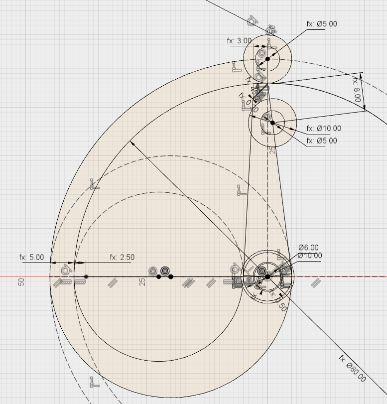

For me, both the thickening as well as the different coloring seems nice but I'd vote using different colors. Maybe it can be more useful if you have a fully defined sketch with lot of constraints. I have attached a sample screenshot from one of my designs to demonstrate how confusing can be when all sketch lines / construction lines / constrain symbols / dimension lines and texts are full black.
