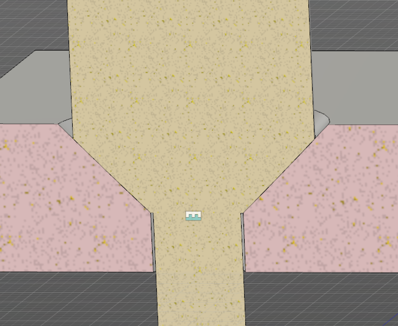

Whats the easiest way to add a rigid joint to the chamfer below the thumb screw head to the chamfer on one of the holes in the fixture? In solidworks I would just select both faces and add a coincidence mate. Is there a way to do this without adding an offset? sometimes I feel the joints work well but so often I miss the solidworks mates for their simplicity and versatility.joint to two chamfers.png

I can use a rigid joint to and pick the center point but it won't make the two surfaces coincident.  I could use a joint origin but then I would need to create a sketch and calculate what distance I would need to get the faces coincident.  I'm not sure that with the joint origin or an offset I would be able to maintain the surfaces being coincident if I change the size of the chamfer on either part.  In solidworks the coincident mate would maintain the contact of the two parts even as the chamfers are adjusted.  I feel like I must be missing something obvious considering this is no different than constraining a flat head bolt to a countersunk hole.

I can see how your example would work because your chamfers are the same length. My problem is a bit different because the chamfered surfaces are not the same length and the joint centers don't line up axially.  I know I could use a  joint origin but It would be a pain to make it so it would change parametrically if the chamfer length on either part is modified.  The one example of something similar is a autodesk video mating a flat head machine screw to a countersunk hole assumed the top of the bolt would coincident with the top of the chamfer. The example didn't take into account that someone might want to have a larger countersink to guarantee clearance in which case the top of the bolt is not at the top of the chamfer.  anyway here is a section view of what i get if i dont use an offset.chamfer joint problem 2.png

Ludo in your examples the bottom edges of your chamfers are the same diameter which is why they work. What I want to do is to join parts regardless of the bottom or top diameter.  My parts are close to the same diameter on the bottom but not exactly so they still are not coincident when choosing the lower edges. This is why I think Fusion needs the ability to add a coincident Joint/mate. I would be interested to hear from someone at autodesk as to what they would do to constrain these parts.chamfer joint problem 3.png

Here's an example using a contact set and a cylindrical joint. You can drag the pin up and it will pull back to a touch.
File attached

yes, a cylindrical joint and a contact set would work but it seems like more work and clutter than should be necessary. Also if contact sets get turned off then there is no garante it will be in the correct position. This would take 2 seconds in solidworks as a coincident mate and it would be positioned correctly until the mate was deleted. I think I'll submit this to the Idea Station and see if it gains any traction.

I'm not actually using parameters on these parts. The Thumbscrew is a linked part anyway so It would be modified outside of the assembly. I'm not entirly shure I follow you Vex. If I use the bottom of each chamfer as the reference it never lines up correctly with an offset of 0.  Right now I'm using a cylindrical mate with a rest point below the chamfer and a contact set to limit it. The problem with this is that the contact set doesn't seem to always update reliably and sometimes I have to manualy drag it to get it to snap back into place. I'm not sure what I'll do when I have 30 or 40 flat head machine screws that need a head clearance on the countersink.  I imagine using joint and a contact set is far more of a burden on the processor than necessary anyway. I'm really thinking a feature is missing here as this seems like a common and very basic thing to need to do.

Here's a workaround using 2 hole features. The first hole sets up the countersink through hole to the smallest size of the cone on the screw so you can use it for the joint. After setting up the screws using joints use a second hole feature to make the clearance hole. With all the joints setup you can edit the countersink diameter or the clearance hole and the screws will stay seated in the countersink.
