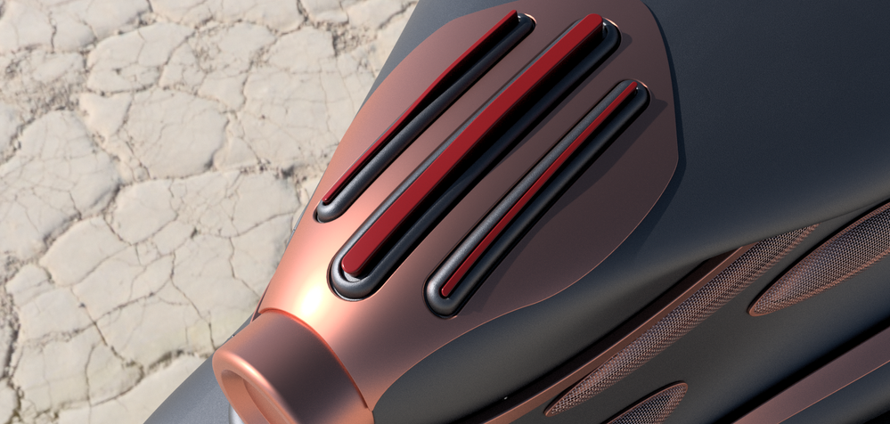

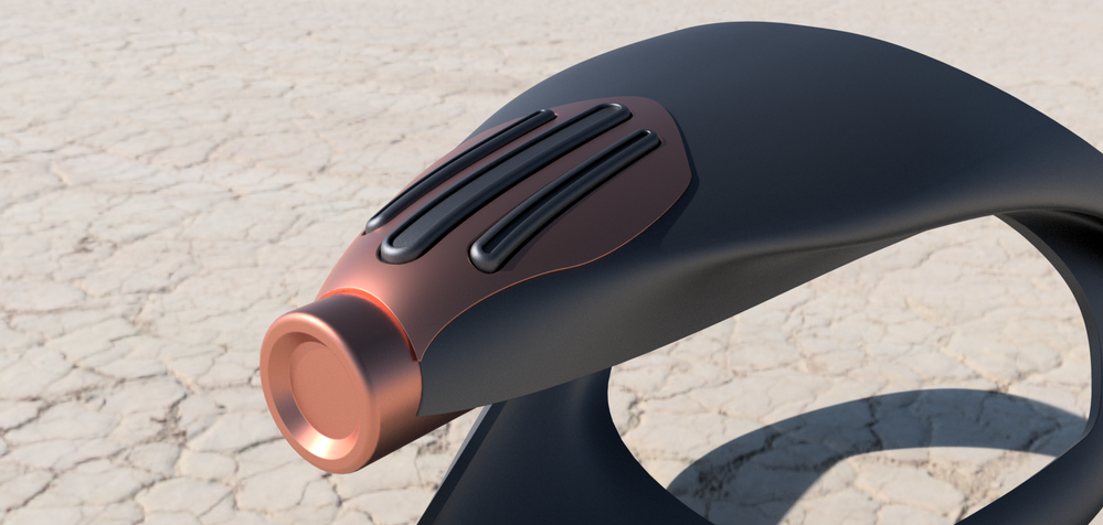

Ok I think I am going to call the LED light ring finished for now.
