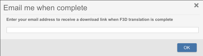

thank you for answering quickly. The download link is http://a360.co/1Q9gr7A
I tried to download the model. Unfortunately I get this message:
If you could give me your mail address I could invite you to my project.
Thank you!

I was able to download the file, thank you. By the way, that is the correct dialogue for downloading. After entering the e-mail address, the cloud will translate the file and e-mail you the download link. I have seen the e-mail end up in the spam or junk inbox before, so be careful about that!
