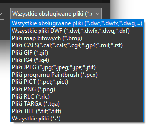

I see that this topic has been marked as solved, however what is really the solution? When I'm trying to open the .iam file in Autodesk Design Review, it is not even possible since they are not supported but this software:

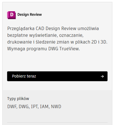

However in the viewers list on Autodesk website it states that it support 3D formats both .iam and .ipt:
So, is there any possibility to open these .iam and .ipt 3D files? I don't see any other software vendors that shared viewer for this type of files for free.
